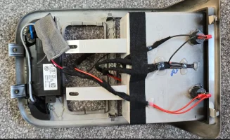

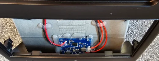

I like this idea!I have a wireless charging module hidden underneath (with switches to turn on/off and to turn the LED I mounted on/off). Chuck phone in and it charges![]()
I wonder if you have a link for the 3D printing? - I could not fine one that fitted...... Thanks
I run a leisure battery (under driver's seat) so it runs off that, cable route follows the existing wiring up there along the top of the windscreen and then down the b pillar under the passenger seat to where I have all of the fuses (re-purposed the OEM fuse block). The charger itself I bought bare from Alixpress, it has an onboard LED but took a punt that a couple of the pads on the board were for an external LED...they areI feel like you need to provide photos as proof of this awesomeness. This is the best idea I have heard about for the cubby hole. Am inspired. Cable route and power supply info/photos would be good too. Good job @phazer
I run a leisure battery (under driver's seat) so it runs off that, cable route follows the existing wiring up there along the top of the windscreen and then down the b pillar under the passenger seat to where I have all of the fuses (re-purposed the OEM fuse block). The charger itself I bought bare from Alixpress, it has an onboard LED but took a punt that a couple of the pads on the board were for an external LED...they areso I could run a remote one. Pics below show it mounted and the switches,LED etc I have a full cab blackout hence black plastic
View attachment 298781View attachment 298782View attachment 298783View attachment 298784
