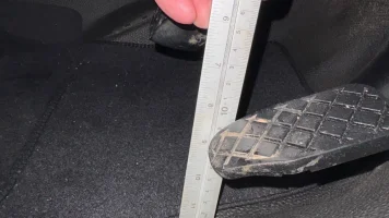

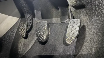

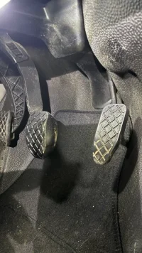

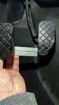

Took these photos of mine for you, unsure if this helps. They do look similar to your pedals
This is the pedal at rest
When fully depressed it hits a stop, which is the bottom of this metal bracket. Just before it touches the rubber mat

Mine looks much more towards the right hand side of the van.
I’ll have to measure between the brake pedal face and the accelerator. I get the feeling the pedal looks slightly bent in mine
