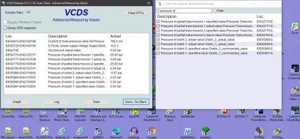

With older cable I would check the following
VCDS > Select > 02-Auto Trans > Adv. Meas. Values
IDE00872-ENG102188 Current of main pressure valve-Oil Pressure Actual Current​
IDE02726-ENG100799 E-Pump: power supply-Voltage Supply Electric Motor​
IDE02742 Oil pressure actual value​
IDE05988-ENG110505 Pressure of clutch 2: actual value-Clutch_2_actual_value​
IDE05989-ENG110503 Pressure of clutch 1: actual value-Clutch_1_actual_value​

Hi Thanks for that
I've attached a screenshot of those items while in D, It was pulling jerkedly, but the figures remained constant.
With R selected the figures were much the same, though clutch 1 and 2 were reversed.
