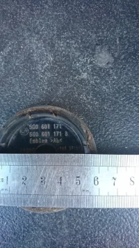

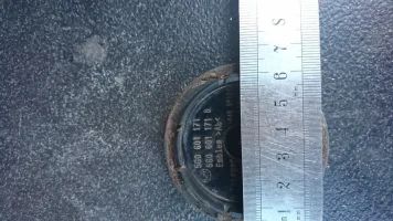

Hello Ajay, this is where I eat my words. I had my new wheels fitted toady and when I went to swap over the centre caps from the old wheels.........they didn’t fit. Both sets of wheels are genuine VW, both also have 65mm centre caps.
The difference is the internal diameter (or the hole in the wheel If you like).
My original 16” wheels use part number 5G0.601.171, the diameter of the inner circle on these is 55mm as is the hole in the wheel.
The Amarok wheels I have fitted use part number 3B7.601.171, the diameter of the inner circle on these is also 55mm but the clips are a lot larger, the holes in the wheels measure 57mm. Before you splash out on these might be worth double checking your wheels by measuring the centre hole.
This is the one that fits the Amarok wheels:
outside diameter:
Inside diameter:
To the edge of the clips:
D1CDB380-C585-41E9-AF25-C2A11392B109.jpegI
I’ve buried the old wheels under a load of stuff in the garage now so can’t measure them again but can say the only difference was the size of the clips. Visually you can see the difference when you put them side by side.
