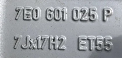

I bought a set of 4 devonports (Which was factory fitted for a 'cali 150HP 4motion fitted with big brakes) part number 7E0 601 025 P, ET55 with 235 tyres load rated 103 which has 7500 miles (very good conditions, at least 6-7 mm left)
I saw on the web that there are many differents parts of Devonport. The T32 with small brakes has the art number 7E0 601 025 with letter N, ET56 with 215 tyres

For the question 1 --> Can I put the devonports (part number 7E0 601 025 P ET56) on my T32 ? Will these alloys fitted for the weight of a T32 ? Are there specific alloys for T32 ?

I have a t32 with Devonports removed and they are part number 7EO 601025 and et 56 so they are the ones:thumbsup:

The Devonport i bought is part number 7E0 601 025 P ET55
I made a mistake three post ago ... I would mean ET55 instead of 56.
It would be nice to have the part number and the ET of Devonports owner who have T32 with Big brakes :-) (may be T32 with 204 HP)
