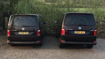

Time for a new Team to be set up I think, since so many are now taking great delight in having Bilstein B14's fitted to their pride and joy.
So come and join me by posting your favourite up close and personal picture of your new stance.
