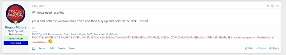

Hi, I had a battery change on my T6 a few days ago. I'm not sure if it's related but I've since noticed that the windows no longer open or close when keeping my finger on the open or close button on the key fob. Had anyone else had this problem?
