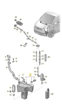

The washertube is attached to the reservoir through a rubber boot(part 7.). It shouldn't come loose by itself when the neck should be attached to the top of the front covling(in the second pictures check the fastener of the pipe).
The connection of the pipe and the reservoir is a pain in the a** to get to. From up top there is a lots of stuff in the way and its quite far away. You can't get to it through the wheel arch, maybe underneath is the way to go?
Thank you for this, I can see clearly now how it all goes together. From this I have either got a hole, split or damage to the bottom of tube 6 on your diagram. Or as previously thought the bottom of the tube has somehow pulled out of the main reservoir body or maybe the o ring pr washer is damaged.

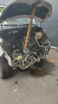

I have a 2023 T6.1.
Recently I have had washer fluid leaking from the passenger side onto the ground.
I have air suspension so put it on the highest setting to get at the inner arch lining. Removed screws at the front to get access to the washer bottle.
Started to pour cold water down the washer fluid neck. As it started to fill up to the top (not quite there) then water started leaking from the bottom. Not sure of there's an over flow pipe or split hose or split washer bottle.
