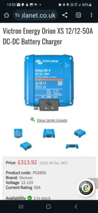

Anybody got any suggestions what to replace it with? Like for like with a Sterling Power replacement or another brand? Been recommended to change to a Victron unit. Any help greatly appreciated 😀
Victron..
The Orion xs will do 50A.(But you're cables and fuses will be sizes for 30A)
But it's BT with an app, so you can see the current limiter too what you like.
Ie 20/30A to match the size cable you have installed.
