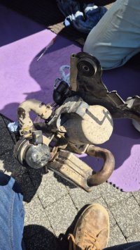

I am right after the burner replacement and indeed it was the issue; the glow plug was even cracked
Taking Webasto off was manageable, first cover, then connectors (some of them really hard to grasp how to detach), then Webasto itself. For the burner replacement this video was of great help
Important to note: get something ready to close the coolant lines since gravity is unforgiving and I lost about a liter of my coolant so I had to get some more.

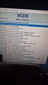

VCDS ▷ Select Control Module ▷ 01-Engine ▷ Basic Settings ▷ IDE08087-Test - bleed cooling circuit

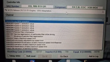

I don't seem to be able to find this option in the list. I am doing as advised:
VCDS ▷ Select Control Module ▷ 01-Engine ▷ Security Access (filling the code)
VCDS ▷ Select Control Module ▷ 01-Engine ▷Basic Settings / Adaptation
