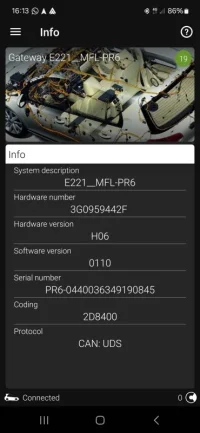

I have changed my steering wheel buttons and now my ACC only increases with 1mph increments.

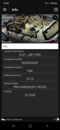

Coding has gone from 2C1D00 to 2D8400. Don't just want to change it back without know what they are doing.

Here's Mine
Multifunction steering wheel control module:
Subsystem 2 - Part No SW: 3G0 959 442 N HW: 3G0 959 442 N Labels: 3C8-959-537.CLB
Component: E221__MFL-PR6 H07 0110
Serial number: PR6-0440036155215438
Coding: 2C0D00

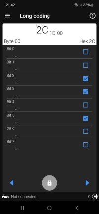

That's the scan, will have to go into module to see all the options.

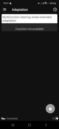

I haven't read my adaptations for the gateway yet so will do that later. Although E221 is in a subsystem and doesn't have the option for adaptations on odb11.

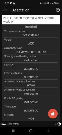

These were the only two things I could find in adaptations in the gateway that related to mfsw. The only thing that looks vaguely relevant is the two stage option is automatic. Options are active or not active.
That article does suggest that some modules it's done in the coding, not the adaptations, but without changing my coding to what it was before, I'm just guessing.
Well, changed coding in E221 back to what it was on the old buttons and nothing changed. All buttons did the same. Weird. Wonder what byte 01 actually does?

I posted the adaptations above I could find in the gateway and none for the mfsw module seemed to be for the buttons.
