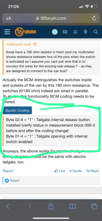

On T6 the BCM distinguishes the switches inside and outside of the van by this 180 ohm resistance. The switches (outside=0 ohm, and inside=180 ohm) indeed are wired in parallel. Fairly confident it's the same on T5.1
Yet another coding thing.
Byte 02-6 = "1" : Tailgate internal release button installed (verify status in measurement block 008-3 before and after the coding change)
Byte 01-4 = "1" : Tailgate opening with internal switch enabled
if it’s a coding issue possibly and if the van has had a new BCM or something.
Any chance to post BCM coding (VCDS, OBDeleven, Carista, etc)?

Just checked the coding for the BCM. The options circled above were not ticked. Ticked off and boom, switch release works .
Thank you guys. Much appreciated. I am wondering why they weren’t ticked now mind as it’s a factory kombi and switch. Plus the coding is not the standard tick options, you go into the byte section. So not just something that gets lost or can accidentally be pressed if you get me. Wonder if it’s had a BCM or something for some reason ¯\_(ツ)_/¯
Anyway though, anyone suffering the same issue the above coding fixed it for me
