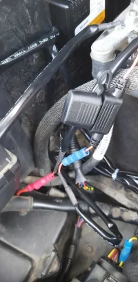

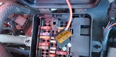

and after all this, the bloody lights would not work, so after a few suggestions and further invest, i found that a) the red live feed has 2 fuses on it? which i thought was odd, the double one in the fuse box using the `piggy` back (plus the original fuse, for whatever circuit is being used) and another in the line, further up as it goes into the control module.
fuse box by arabianjules, on Flickr
in line fuse holder by arabianjules, on Flickr
Anyway, volt meter says im getting volts from connection from fuse box, so i `take out` of the circuit the other in line fuse, above, and the lights come on!
So am I safe to run them, like this?
thanks for looking and any feedback..
