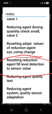

Just for everyone's info:
On a "T6.2" (T6.1 wit DNAx engine) like yours,
I just tried to reset the Adblue level to the (working) sensor level with OBDEleven Pro.
It does NOT work, the function is not available (bonnet was open too).
That not because I have a running problem (yet), but Adblue mileage on the dashboard is stuck at 29000-31000 Km whatever quantity of adblue I have inside. There is no inication of quantity to add on the dashboard menu.
So I just trow in about 5 liters/one gallon every 6 months or so (that may fill it to the brim, but does NOT make any diffence)
For my experiece adding 4 liters is about 25 mm more on the level sensor indication (OBDeleven live data).
This is consistent with the full tank measuring about 140 mm. If anyone has better references or measurements (I always made mine in a hurry) , he is welcome to post them
BTW I have the big tank (22 liters I think), that should be standard on the T6.2.
As I have said already, I think the Bosch ECU works completely differently from the previous ones, early T6.1 included.
