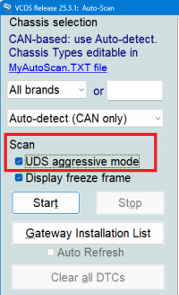

Quite a few faults were captured at low battery voltage?
Including the strange one - P0606 00 - at 11.220 Volts, although has happened only once.

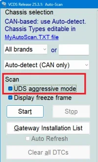

By default VCDS uses "aggressive mode" to scan vehicle's fault memory. Usually this mode brings up more faults than dealer tool which filters out "expired" faults (=faults which have not reoccured for some time).
That P06060 00 is showing up at the time the car would have been started ready to go to work. Nothing was left on overnight in the car and the car started normally with no issues or sluggishness on cranking.
Yes, noticed that engine was already running - perhaps it was just the brief moment after engine was started and alternator was not yet charging - thus the (too?) low voltage.
For reference on T6 it takes more than 2 seconds after engine is started and running before alternator starts actually charging.
