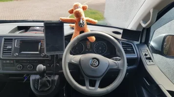

As per title can anyone recommend a VW group plain leather steering wheel that will fit my T6?
I have the plastic startline one fitted currently and its ok but a nice chunky leather one would be better. No cruise or ACC etc so no need for buttons!
Alternatively, has anyone fitted a leather cover for the 70’s style driving experience?
