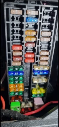

Quite possible. I did have a look at this already. And of course forgot to take a pic before I started.
can you get a better pic of the lower dash fuse box?

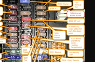

have a look here . .
middle row . . . SC29,SC30, xx, SC32
@Loz has - 10A,10A space 7.5A
i have the same . . - 10A,10A space 7.5A
your looks different?
