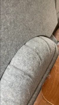

Just in the process of doing my T6.1, I’ve come to barn doors with no windows, now I sound deadening and insulate the lower portion but do I put any on the upper? I’m thinking that any carpet over the top will show up the dodo sound deading or will it? Also on the wheel arches I’ve sound deadened but looking at other builds I’m assuming I don’t insulate them as it would be too thick. Any advice greatly received, thanks.
