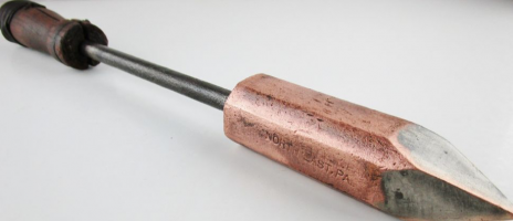

I use one of these on the heavy stuff, heat it up with a gas torch and fix it in the vice.
Cheap and available on ebay etc.

I used to make my own - 22mm copper pipe beaten into a lump with a FBH. Cheaper than Ebay! ( Not that Ebay had been invented then)
