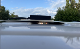

Got around to fitting 2 Renogy semi flex 100W panels on Saturday along with a nice Victron MPPT controller. I know there’s different theories around regarding the best way to install the panels but it makes a lot of sense to me to use vinyl on the paintwork first and allow air and water have free passage underneath.
I didnt go OCD with the black and white vinyl and matching Tech 7 I just didn’t have enough or either colour for the full job! I’m making a little spoiler/deflector to go an inch or 2 in front of the panels to avoid too much air getting underneath but to be honest it’s probably not necessary but might look kinda cool.B41D98AD-CAD0-487B-B07F-F6221D12E9CD.jpegA36DA732-51F9-4BDA-8150-2E98221BCFE4.jpeg

Ignore that picture below that was just the panel lying on the roof before sticking it down !
just fill in these bits.
.. I dont want to seal this end as any water that gets in from the other will end up getting trapped especially as the van has a slight rake forward. I am however working on a little spoiler / deflecter that I'm going to stick on an inch or 2 in front of the panels to take the air up over them
