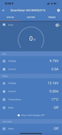

Solar panel output only 9v

I’ve also checked this directly at the two solar cables.
Anyone else seen this issue? I assume it’s a problem with the panel itself?
Ollie
My panel failed recently. I borrowed a spare panel to prove everything else but mine was pointing towards the panel itself and it turned out it was. Although mine seemed to output slightly until it had direct sunlight and then volts died off.
defo check the panel.
with good strong light you should see a decent PV voltage.
even if the battery is full and not drawing any amps.
Ollie
I had exactly the same issue = dead panel. Replaced same = all ok.

Mine was a 130 watt panel from photonic universe. Lasted 2 years. I have bought a cheaper one from amazon this time and see how long that lasts now.
