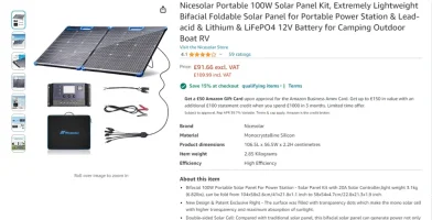

I've not tested this specific one , but its an example:
100w fold panel,
with PWM controller.
the battery clips will need a fuse adding.
or add your own 12v plug to back feed via a 12v socket.
