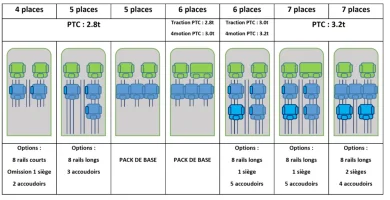

this is the seating options the fitting company offer:
The rails look quite short, how much space do you actually gain? Still looks pretty tight?

You can have the rails the full length of the van is you want. I chose their standard option as it worked fine for me. With my seats fully the rear there is a lot of leg room. Also I really like is the quick release, the seats are out in 30 seconds.
