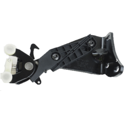

Newbie to the site here! I've got the same issue with the near side roller of my 2016 VW T6.1 Shuttle (Multivan).
I spoke with Just Kampers in the UK and did a search on what was needed using the VIN number. Two part numbers are stamped on the bracket:
7H0 843 397 and 7E0 843 397 G
Searching on these numbers, none of the parts looked correct from the links on here, due to the child lock cable management etc.
From the VIN Number search, the correct part I need is 7LA843397 which is correct, but only appears to be available as a OEM VW part at £170!!!
Any thoughts on where I can get equivalent other than direct from VW? Or is the Newbie missing something?!

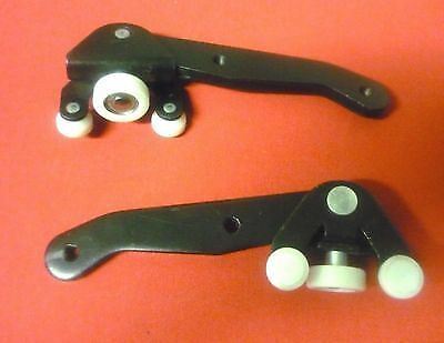

There are plenty on eBay. I’m fairly sure the T5 and T6 use the same part but check first.
Like this:-

Part number is 7H0 843 397 but there are a couple of variants.

Edited - assume this is ok - advertised for T5 but part number the same (I have a 2017 T6):
And there’s also this:
