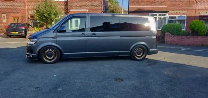

Side on Sunday.
What’s the part number for the rear spring? It Should be the harder rated version 29270 - 2 HA (R) which is the correct one. If it is then you can fit KW spacers I believe.
Possibly worth talking to a suspension specialist chap @BiTurbo recommended if you're stuck. PM me if required.
BTW, how do the spring ride like? I’m fitting a set with Koni active shocks this week.
Im not sure of the part number? They were fit by the conversion company. All i know is that they are h&r 40mm drop. The ride is fairly harsh with the 20's but i'd be more than happy with it if i could raise the rear to level it
