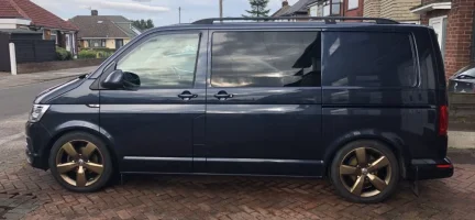

Nice colour van , what wheels are they ? :)
busside-jpg.49196
Hi
have you had a camper conversion etc.. kitchen etc.. I presume you are running on 20's and yours looks nice and level. Our camper is low at the back and I want to level it up.
What suspension are you running? With standard you can uprate the rear spring poundage or use a coil spring spacer / cup as options.
we have H&R 40mm drop springs on, I'm happy with the front height so all I want to do is lift the back so its level. I appreciate i can buy B14's or the Eibach ajustables to level it but i wanted to see if it can be levelled cheaper first of all.
What’s the part number for the rear spring? It Should be the harder rated version 29270 - 2 HA (R) which is the correct one. If it is then you can fit KW spacers I believe.
