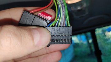

Measure voltage on your 20 pin plug (terminals 19 & 20) and see what the voltage readings are when it is plugged in and plugged out.
Hi Robert,
By chance have you stumbled upon any in depth schematics for E265 rear air con display unit? Maybe there is somebody who is repairing these? It's crazy how much they want on local scrap yards and ebay for these. 7e5907049b for sale | eBay
I have 7E5907049B for my T5.1 2012 and it looks like it's shorting internally.
When connected it gives:
When unit is disconnected
some green stuff
Pins and cennector look good
