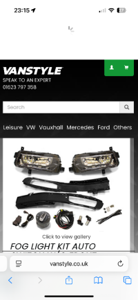

Hi, sorry I know there are some threads out there already on fogs but I can’t seem to find the info I need. I have the Van Style pack in the picture. I need some advice really on where people are mounting the relay under the bonnet and does this need to be to bare metal for earthing reasons. Also once connected to the battery and fogs one single white cable is left to run through the bulkhead. Where does this go? Is there a specific PIN number it needs to be added too? Thanks in advance for any advice.

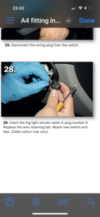

The single cable is the trigger for the foglights, if it is pre terminated with a crimped connector then it goes to the headlight switch plug and populates and empty pin
