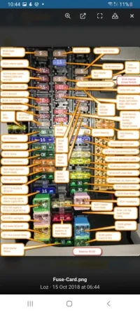

I think i found the answer. Saved this image off the forum.
The fuse SC49, 15A is for the 12V cigarette lighter... the one 2 slots down, SC47, the 25A one is marked as turn and brake lights... I didnt realise my brake lights weren't working either. Thats the one i dropped.
