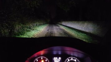

Well that looks like the solution! Fantastic strong and consistent beam.
Unfortunately illegal and could mean your insurance is invalid depending on the incident. Each to their own though of course.
Difficult to tell from a pic but the top dipped picture has little cut off. The way it is lighting up the gate on the far right looks like it could be pretty dazzling for oncoming drivers.

Read into my pictures above what you want but do bear in mind I tend to mostly drive around on dipped beam which is the top picture, as you've pointed out the gate is slightly illuminated but so is the background sky by sodium street lighting from Daventry 15 miles to the east, on main beam in the bottom picture loads more stuff is illuminated which really helps at times, just saying.

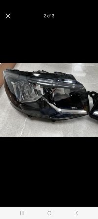

Is there any way of telling the difference from the front if you can't see the sticker? Just seen these on marketplace Screenshot_20221121_185251_Facebook.jpg
Those are H4s. The giveaway is a dimpled reflector of the inner light chamber for the DRL

I look for the hole in the reflector with the little bulb sticking out.
Hole outside of the bigger bulb =H4
Hole to the inside of the headlight =H7
And as @dubber36 says, H7 with the DRL under the main reflector, H4s just a black void!!
As I said, each to their own and it’s difficult to tell from a picture.
It’s not main beam that’s the problem, because hopefully that is not being used with someone else coming the other way. It’s the poor cut off and glare in dipped beam that is common when LEDs/HIDs are put in reflector lenses that are not designed for them. That is why it is not approved. That’s not to say every one is poor and there are probably combinations that are fine (although unfortunately still illegal). Passing an MOT is no proof of legality and just shows how lax the tester was as LED/HID bulbs in a halogen designed headlamp became a mandatory fail from Jan 21.
