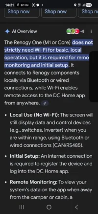

Have you connected to renogy kit via Bluetooth?
I needed to use a BT1 renogy Bluetooth adapter to the dcdc, then connected the battery via rs485 cable.
So what happens when you connect direct with BT?
Nice one thanks. That’s an interesting read. I’ll turn my one core off and then try the app

Couple of things come to mind, the app is pretty terrible for showing old information and I find shutting it down and reopening is worth trying first. If your away from your home and no wifi in the van then you need to change in app to use a direct connection but it does not show my core one only the individual Renogy kit with bluetooth.
I’ve worked all that out now. Exactly how you mentioned. It’s not a great app. I’m really happy with the system and how it works, it’s just the interface side of it is a bit of a nightmare.
The ONE is WiFi only.
