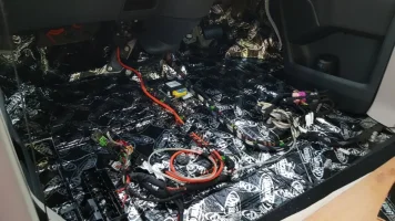

IMO you dont need to worry too.much about every little bit of floor.
Remove the seats, unclip the fuse housings and then remove the seat bases.
When i did mine I worked around everything that was more hassle than I needed to remove
.. somethings are obvious but If I could work under or around it then i did.

Handbrake is pretty simple of detach from the floor and move to one side..if you want to cover under it.
I also found it helpful to remove all the lover dash panels to get high up bulkhead as possible.
I have proberly gone over the top with my sound deading but that was my choice.. each to their own..

I’m not going to do this again, I went nuts on my T5, getting all the cab carpet, seats, bases, everything out and covering every square mm in dynamat followed by close cell foam - Made bugger all difference! In fact my T6 without anything is already quieter than my T5 after I’d done all that work. Most of the road/engine noise I hear now comes through the front windows oddly :confused:
Passenger side will just pull out if i remember but the drivers side as a couple of screws holding it, best look before you start pulling to hard ;)
I also covered these panels why i had them off as it all helps. Made a difference in the cab IMO
