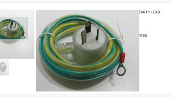

you could make a easy UK plug in version.
make up a UK plug with the fuse removed and a single wire connected to the earth pin in the plug. ( wire needs to be fat enough to be able to carry the full fault current back to the EHU post so maybe 2.5mm multi stand?)
then have a wire that's run and bolted to the chassis.
then when mobile camping, if the plug is plugged into to your EHU lead in the van, the vans chassis will be connected to the EHU post( and become a PE earth).
an example of a AUZ plug version below.
