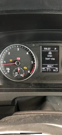

well it was only a matter of time - flashing coil and EML and the power of a splitty.
So that running about with only a quarter of a tank to stop the regerations wasn’t such a good idea after all?
Well at least you did the experiment so we don’t need to :)
So basically there is no issues doing it for a few hundred miles but close to 1000 miles is a step to far ha
The VW assist guy said that its very common as there is a major design fault - the DPF light doesnt come on if under 1/4 tank. So essentially it doesnt warn you it needs one.
As you say lesson learnt and not damaged caused.
