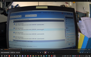

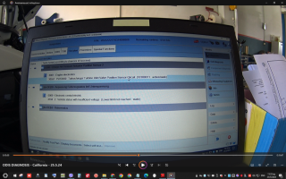

Hi people,
The chap looking into the issues with my Cali sent me these screen shots if anyone has some advice/help,
As there was a low voltage mentioned on one of them he said the van was slow to start and maybe change the battery as it mostly likely is the original 2018 battery - I haven’t changed it in my ownership just over 2 years. He also said there is new fault code which wasn’t there before the P0641-P0651, any ideas please.
If your battery is old and showing signs of dropping capacity then I'd always recommend starting with a know healthy battery if you are having electrical weirdness.
You seem to have a lot of wiring or data communication faults cropping up, those could be due to electronics dropping out under low voltage conditions. They might not be your root problem but they may be clouding the diagnostics.
You said start/stop was unavailable, has it been working normally until this point as that's usually a good indication of overall electrical health?
Reactions: DXX
Thanks Roadtripper, from memory I think yes but I do remember at the euro tunnel it might have said unavailable then our problems with the coil light was about 300 miles after that, but interestingly when we got to our first stop and while on hook up the two front courtesy lights dimmed and went off on the odd occasion ( are these run from the starter battery?) at this point I also noticed the radio would say it was shutting down soon after ignition was turned off.
So I’ll ask them to try a new battery and see where we go from there. Thanks again
