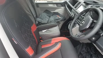

what arrived were these . . . . true to their word a set of OEM covers : ZGB 7E0 062 007.

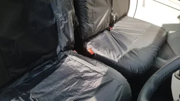

you can see the temporary old grey ones on the bench seat. . . . The factory leather seats looked way to nice to not have permanent covers for basically a working van. . .
The drivers seat cover come as a single piece with additional arm rest covers and a head rest cover. following the instructions were simple as . . . . though it was a VERY tight fit at first.
It was a case of removing the head rests first and the placing the covers over the top, there were a few clips and hooks that went down the back for the seat base and hooked on, all the pieces lined up perfectly . . . .
The bench seat cover was similar, though the lower seat base was a separate section, again with tags and hooks that wrap around to keep the covers tight and snug. . . . . .
it took a few days/week for the covers to stretch out, so there were a few re-visits to try and stretch them again to make the velcro seams match up.
They been on for a couple of months now and have to say im very happy with them.
i much prefer the black colour and the fit is as you would expect - perfect.
