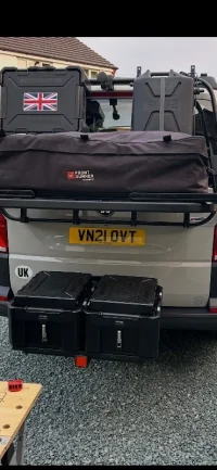

Swapping over the tow hitch to the pin version, incase I need to put a tow strop on the rear of van, I use those soft shackles these days, very easy to use.
I have my homemade Front runner storage box mount fitted on the actual ball, handy extra storage and doesn’t need a lighting bar.
Ps, we have a u shape layout so don’t need to open the tailgate as everything is accessible from inside van.
The big bag on rack stores our external poptop/windscreen covers, steps snow shoes, etc, basically anything that gets wet and dirty.
The black water jerry can will be replaced with a yellow diesel jerry can, and will fill it up when we get to a garage that sells very low temp fuel in Sweden.

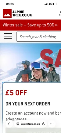

This will be
the first time away in the van that the Crocs won’t be coming with us, we have upgraded to another type of high fashion plastic footwear, the Viking insulated wellies, and when you’re on a budget, the cheapest colour wins, they are actually proper Nordic spec winter wellies.
The dry robes will be coming along for the trip.
Found them..
Viking.
Look like 11.5 is the largest
