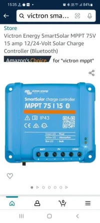

I am looking to charge the leisure battery via the Jackery 100W panel, can anyone advise what I will need such as MTTP etc. I am also hoping to buy a DC connector so the Jackery will plug n play
@Eli get a Victron 75/15 smart. Mppt solar controller.
Then a DC barrel connector fly lead. To connect the panel.
Then hook it to the battery via a fuse.
Thanks Lee, any suggestions on which Victron 75/15 as the seems to be various ones
BT built in on the "Smart" version - Extra on the "Blue"
so its included on the one above
