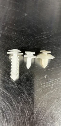

Reviving this as I have a similar issue. I've carpeted the roof and can't get the existing clips like the one below to hold due to the extra thickness. I ordered some longer ones on e-bay but they are so brittle they snap if you look at them and I now have one stuck in the "receiver" part of the clip that is in the metal work.
I'm thinking I could just remove / drill out the receiver bit and use the middle white one shown below which just about slot into the rail and would (I assume) be the right size for the hole the receiver sits in?
Has anyone done this or found an alternative approach that works?
