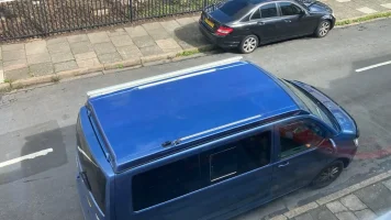

Followed thread closely. Pop top was showing some odd matte patches.
Tried Polytrol, as per others. Worked amazingly it would seem for 12-24hrs.
Still much better than was but matte patches have returned. Not so bothere by aesthetic, but concerned re: long term.
Any wisdom? What could be the issue, will this cause long term degradation? Any solutions found?E2968B4B-F79F-4DF9-A957-EBC0FAF47DBB.webp
It looks like its been painted and the clear coat is starting to oxidise. Get to it swiftly and a careful machine polish may well revive that. Could do it yourself if you have the gear, or else a proper car valeter/detailer could do the panel for you. Probably not too expensive.
Once the clear coat starts to fail and peel then you're stuffed, you'd need to get it repainted or possibly rubbed down and wrapped. While the surface is still physically intact there's a chance it can be revived.
If you attack a small part of that matt area with a bit of T Cut, Farecla G3 or similar and preferably use white cloth to show if the cutting compound fetched off any of the paint pigment indicating single stage paint ie. cellulose or if the cloth stays the colour of the compound then you've got a clear isocyanate coat finish over a colour base coat.
As @Sasquatch says if the clear coat has gone porous then the Matt base coat underneath will discolour/oxidise and all bets are off but if your clear coat is intact you can probably fetch it back to life with the cutting compound and a wax polish. Also, again if the clear coat is intact, you could give it a light flat with 400 wet and dry and get some 2k aerosol clear coat (expensive) and respray the affected area, don't use a single stage clear coat as that's nowhere near as long lasting.

I applied Polytrol to the roof back in Jun. Achieved a matt finish but given the state if the roof before, I was perfectly happy with that.
We are now into Sep and there are no signs of the roof returning to its previous chalky state, so it gets my thumps up.
Guy spent 15mins with machine polisher. Thinks it will sort but ‘may come back’, hypothesis maybe something previously penetrated gel coat.
Asked me to go away for a week with small patch he has polished. See if maintains.
Quoted approx £100-150 for full machine polish.
Quoted approx £600 for respray as would require some careful sanding of damaged areas.
Discuss…
If it polishes out OK keep with well waxed or sealed with a good quality ungent. That'll keep the dirt off the actual surface when it won't be able to react with UV light and damage the finish.
Leave it untreated and as sure as eggs is eggs it'll return, the only question being how quickly.
image.webpIf you can see top left of photo, in amongst patch of discolouration, the little circle is what he did. So I guess wait and see
Any ideas next steps?
A) leave it, is integrity a problem?
B) repaint?!
Guy today quoted 500-600£
Had the van for 6 hrs, I’d hope so, he was “not sure” what had caused fading/ matte patches, but did suggest £5-600 for a repaint, and “even then may not be sorted”.
Not sure where to go now to be honest, feel I’ve wasted a few hundred ££ today:(
I’ve emailed him a pic, not to try and get any ££ back, more to ask him for his opinion. Surely should have lasted longer than this?
