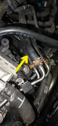

Hi all, after some technical advice please. 2017 vw transporter. CXEB. Problems starting when left for 5 mins or more. Hooked up a fuel pressure gauge on the low pressure pipe to the pump. It cranks for ages but eventually starts when the pressure hits 1 bar. Have done a leak off test on the injectors and they are all OK. Fuel filter changed also as a precaution. Have replaced the fuel pump pressure regulator too. Visual inspection of all fuel pipes and no visible leaks.
In addition if you clamp the return hose from the fuel pump you can leave as long as you like then remove the clamp and it will start straight away.
It seems that the fuel is running back to the in tank pump. But I can't figure out why. Only done 16000 miles!
