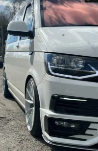

A 15mm PCD adapter is going to give you an effective offset of 30 on a 9.5” front. That’s going to give you a fair bit of poke past the arch. Not a look that I like personally.
Yeah that’s my only worry, think it’ll look and fit ok?
Ta
I ran a 10jx20 et 42 with a 255/35 tyre that had plenty of stretch. You are looking at it pocking a further 5.5mm so i think you would need a big stretch to get away with it.
Thanks for your reply mate . I think I’m leaning towards steering clear of it !
Van looks great by the way!
