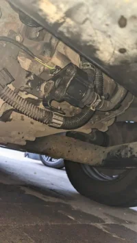

GavMc P11GT Senior Member VIP Member T6 Pro 16 Jul 2023 #43 I’ve not had chance to look at ours further might get a chance to do it this week! Have noticed when I unlock the van this motor starts to run making a loud buzzing sound! Is this normal on a T6?
T6Bob32 Aircraft Engineer 2017 147K Camper VIP Member T6 Guru 17 Jul 2023 #44 Its the motor turning in the housing. Mine did it when I put the ignition on, not when I unlocked the vehicle.
GavMc P11GT Senior Member VIP Member T6 Pro 17 Jul 2023 #45 T6Bob32 said: Its the motor turning in the housing. Mine did it when I put the ignition on, not when I unlocked the vehicle. Click to expand... Ah I gather that’s not normal then probably why I’m getting all of the live faults on the egr pump
T6Bob32 Aircraft Engineer 2017 147K Camper VIP Member T6 Guru 17 Jul 2023 #46 GavMc P11GT said: Ah I gather that’s not normal then probably why I’m getting all of the live faults on the egr pump Click to expand... I don't know what's normal and what isn't tbh. At least you know it's turning. My old one wasn't turning at all.
