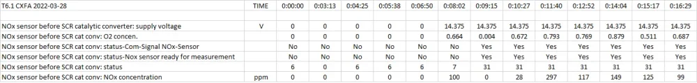

Hi mmi,
Thank you for taking the time to reply. It is much appreciated. The Van is a 2017 and started as a panel Van.
The 11 leftmost digits are WV1ZZZ7HZHX I think the engine is a CXHA.
I have tried a friend's OBDLink MX+, and the results are the same. However, it does provide more information. Even after clearing the codes, the light stays off, and they still show as pending. I have attached some screenshots that might help?
Thankl you again
Mark
Reactions: mmi
Then it's just one NOx sensor.
Note: the snippet in my post #5 was from an engine with two NOx sensors but the principle is the same. Just need to look for "NOx sensor after SCR catalytic converter: supply voltage" etc.
Sounds like the fault is permanently on - the engine probably needs a few driving cycles to be absolutely sure before turning on dash light.
