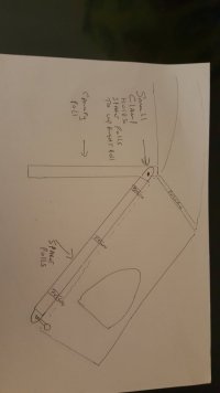

I have just worked mine out, the bolt goes through flat black section and bolts to top of upright pole. Extra pole is then at a 33 degree angle. Then peg to ground through flat black section on other end of spare pole. Velcro side panel to this pole and it is a rigid side to the side wall

Can we have a picture please this has worried me for years lol
It makes the side much more rigid and stops it flapping in the wind. I too had not used it untill this weekend when the lightbulb come on due to a windy day.

Going to give this a go ASAP Thks for the detailed drawing
