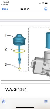

Just a quick question, where did you put the top o-ring (biggest) if you put it right up to the lip it will leak, it sits in a grove just a bit below.
I know this because I did it last year :rolleyes:,I made sure I got it right last weekend.Screenshot 2024-03-10 at 11.59.15.png
