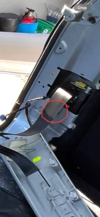

The seatbelt is hiding the hole, but you can just see the edge of it in the red circle.

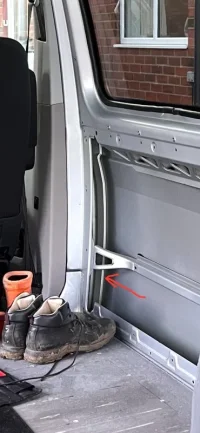

I can’t now remember if it comes out in front of or behind the panel marked with an arrow. If you poke something through it’ll become clear.
Bear in mind - please do read up on cable safety in vehicles - for example by using grommets, the two types of cable sheathing available (and when to use each) and the importance of using flexi conduit in some circumstances. I’m not an auto electrician.
