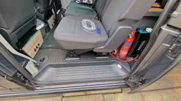

Trying to tidy up wiring from lesuire battery under single front passenger seat, to inverter at rear section of van (don't have room to put inverter anywhere else).
See photo of locations and current wires (photo for attention really)
Not far, but can't see anywhere to route the cables under van then back up near the inverter location.
Whats others done in similar?

Yeh i've done similar with other wires, but because these are heavy cables for the inverter need to be more direct, otherwise I think I need to up them more and they are thick enough already :/
You don’t have to use a single cable to get the required cross section. You can use multiple cables with a secure busbar termination at each end BUT each cable must be adequately fused. `This may or may not reduce the cable volume / reduce the bend radius and make it possible to pull through apertures.
