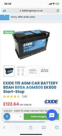

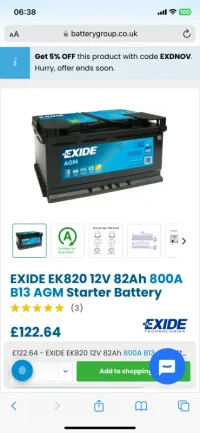

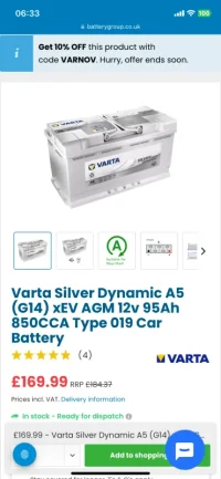

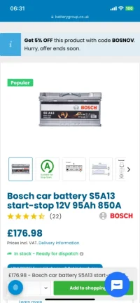

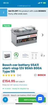

Thes are batteries I’m looking at. The first three are standard and the second two are what I believe to be the next size up. Any thoughts on these before I make the jump.
Are you able to code a bigger battery in?
should be able to. FYI I fitted an Exide EK950 to my T6, which is physically the biggest battery that will fit. It's tight, but it does fit. We use our van all year round, including in the Alps, so we need plenty of cranking capacity. 3 years on & all good.
