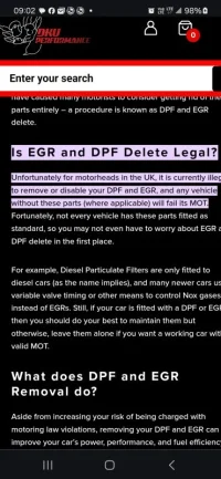

And EGR delete is illegal on UK roads.(Also an MOT failure and will invalidate your insurance)

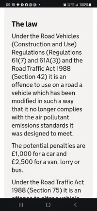

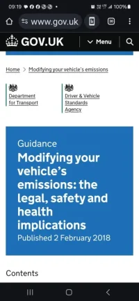

In the UK it's illegal to tamper with or remove part of the emissions control system if it was factory fitted.
The egr is part of the emissions system along with the adblue and dpf.
